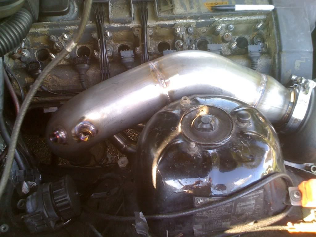

    The forum member building my manifold (GoodnTight) sent me pictures of it all bolted up while he works on the downpipe. It is a Precision 6765 dual ball bearing billet, T4 twin scroll, full 4" downpipe, 4" intake, 3" outlets.
    -Mike
