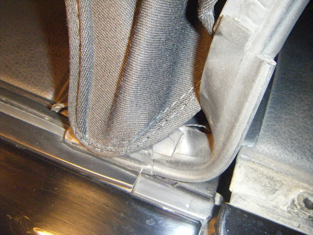

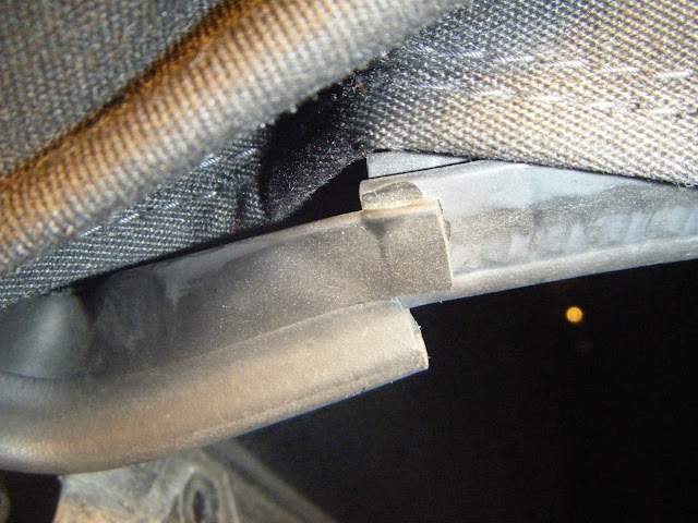

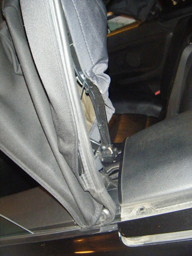

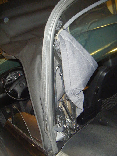

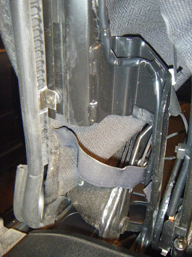

Here are pictures of what the seals look like under the soft top. You should not see big gaps (although I know tons of E36's have them).
These pictures were from my 1996 328i that had one of the most pristine condition soft tops I'd ever seen.

I am interested as well. Literally 100% of E36 cabrio owners never speak of this part nor do they know of it. I"ve been wondering the exact same thing--why would BMW design a car with an open and obvious big gap between the body and the top? You can literally see right through it. What part # is this?
BTW Is topped my leak by applying "Gummipflege" to the seals. It took a few applications and a couple weeks for the product to "set in" and work. Have had HEAVY rains and car washes since and no leaks. I also sealed the top with Porsche brand canvas protectant which I purchased from Pelicanparts

I can't find a part number on this that would seperate it from the soft top frame. I have to believe that it would have been made seperately, but I can't find it...

Looks custom/hand made to me.
