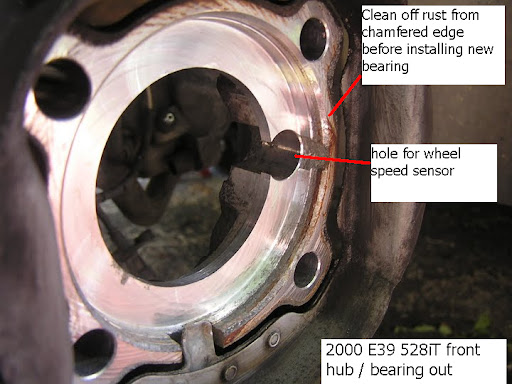

Make sure to clean up hub surface before installing new bearing. Mine had a little surface rust - see photo:
Jason

Originally Posted by jase007 View Post
Make sure to clean up hub surface before installing new bearing. Mine had a little surface rust - see photo:...
Very good advice!!!
Regardless of whatever job you do (Valve Gasket, Wheel Bearing, Water Pump etc.), Cleanliness of the Mounting Surface is a MUST before installing any new components.
