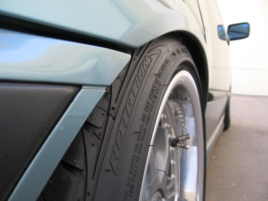

    215/45/17 Falken Ziex ZE-512s on my Style 19s and Style 5s
    Rear fitment (prior to fender rolling)
    Rear fenders have been rolled in these pics

    Quote Originally Posted by Jean-Claude View Post
    Is there any way to get 245s on it without rubbing? Is it the inner or the outer fenders that will rub?
    No, not without going widebody.
    I tried 225/45's on my style 5's and it rubbed like crazy even with my rolled/slightly pulled fenders.
    215/40/17's, hub rings, and rolled rear fenders = good to go
