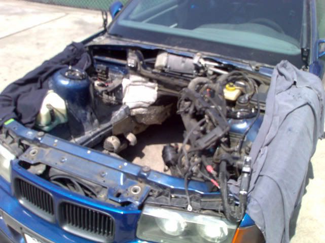

    DONE.........easy. 1-2-3.

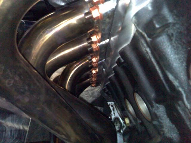

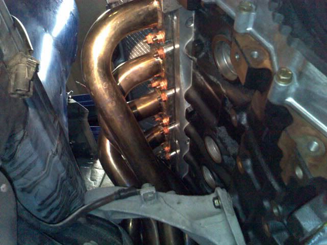

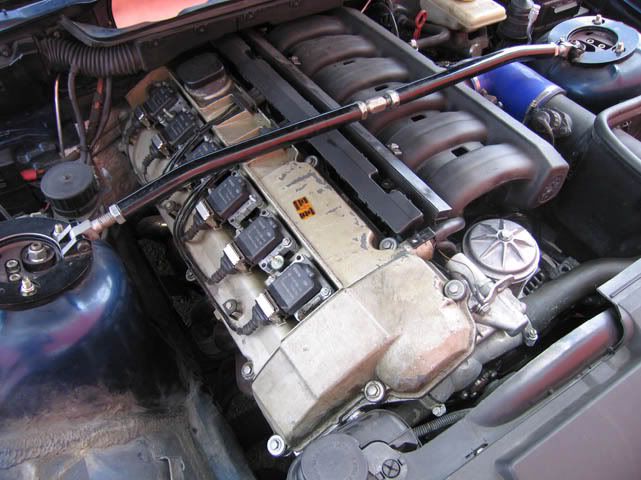

    Threw on some ebay headers

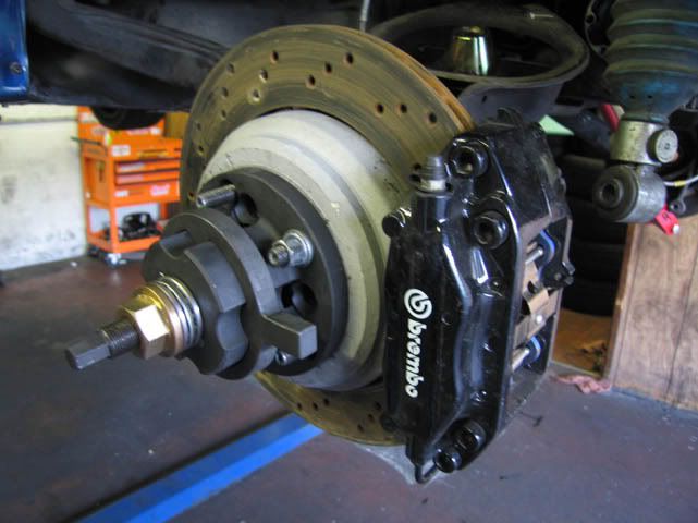

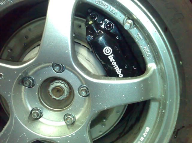

    Then came some brembos......

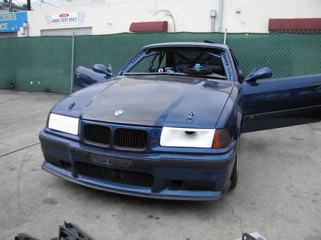

    cage time.....
    Then after a code brown moment at buttonwillow decided to install a auto power cage.....
    well, that last 1 track day since I hated the fitment and after the event due in part to my friend Pedro's insistence and persuasion. Decided to make the car a dedicated track car. Maybe do some NASA TT So out came the crappy autopower cage. Out came all the interior, headliner, took the tar panels out with dry ice.....etc.........etc.....
    Decided not to race with BMWCCA......since I really enjoyed the atmosphere of NASA..... so I figured I build the car for TT and maybe in the future GTS class......

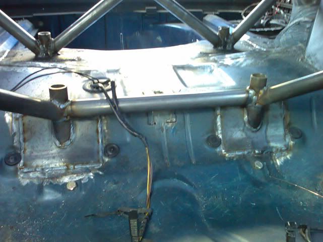

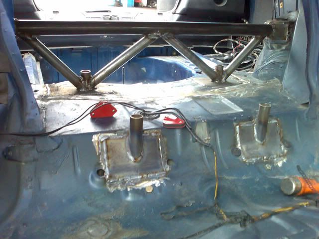

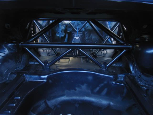

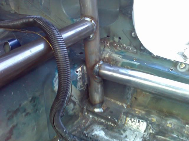

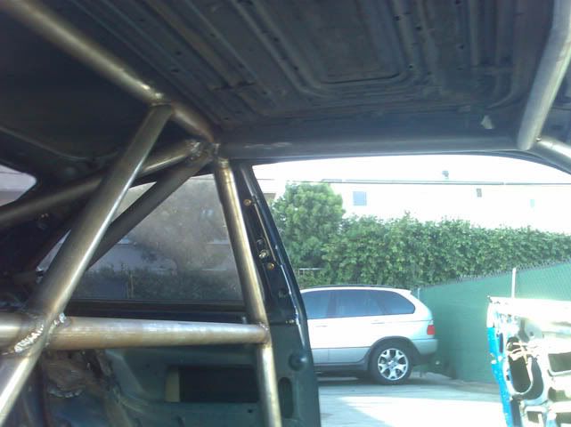

    First the main hoop base plates
    Main hoop in

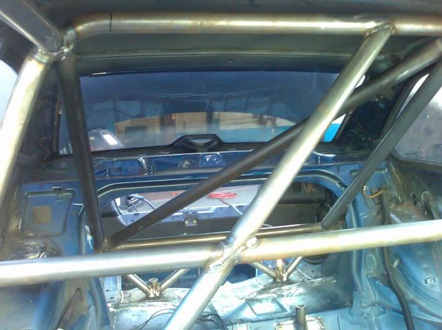

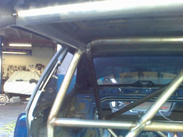

    after taking a look at many build thread and websites finalized my cage design and ran subframe connector tubes to be tied in to the cage later
    tacked in the front
    connected the subframe tubes
    finished basic structure
    as you can see I gusseted the A-pilar tubes

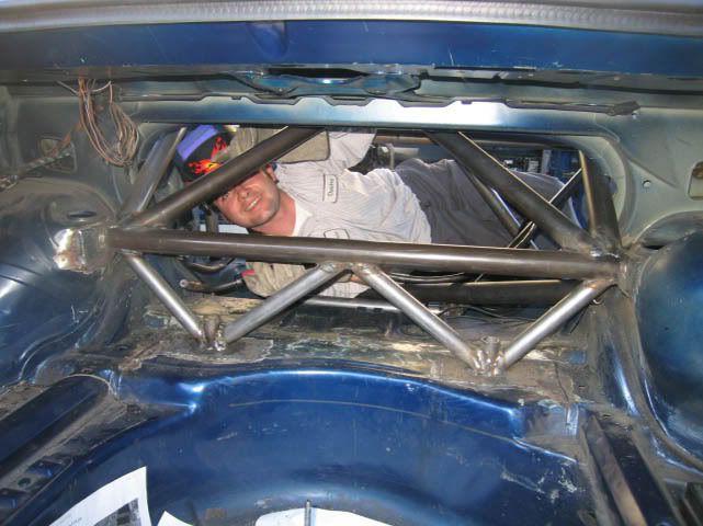

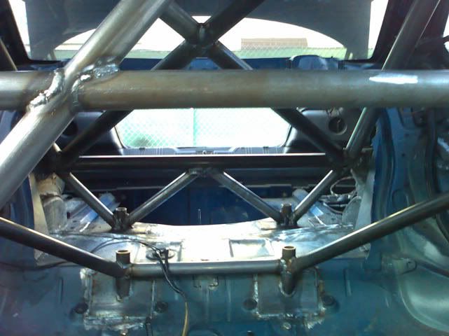

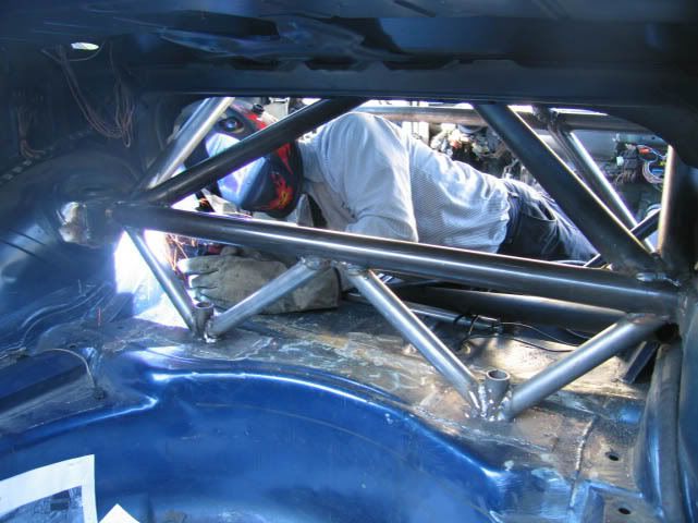

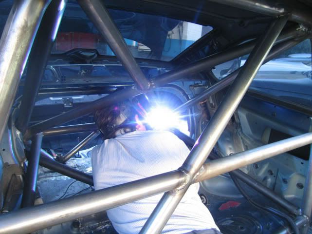

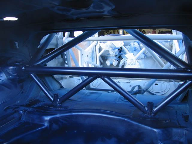

    there me doing the final welding on the rear strut tower tubes

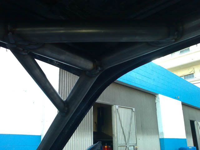

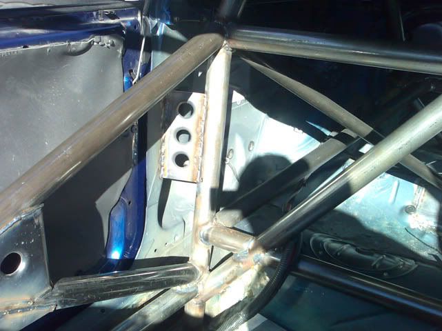

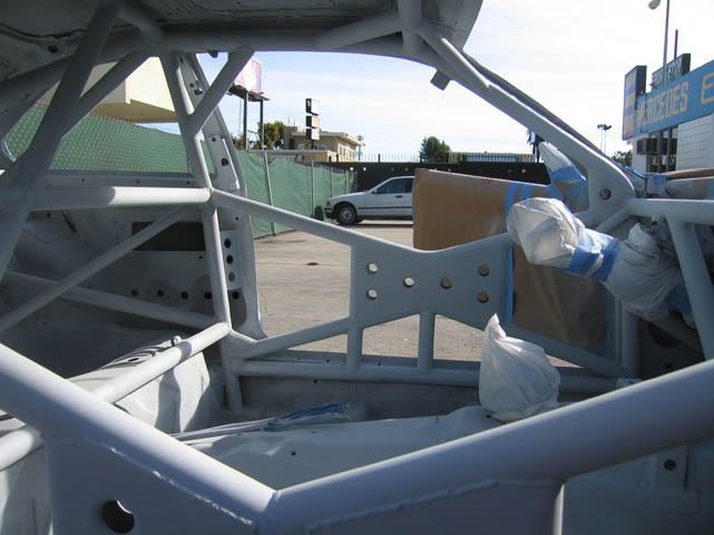

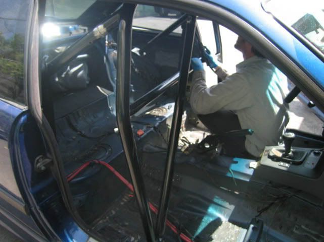

    more cage work!

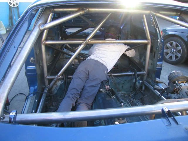

    contorting myself while welding more of the rear cage tubes

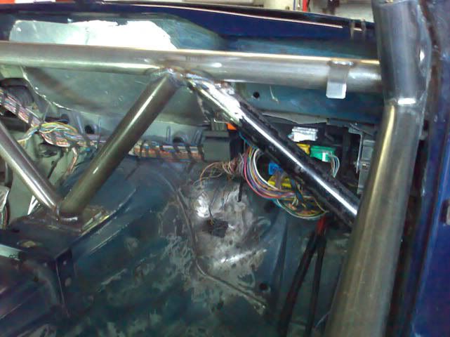

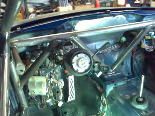

    got creative with some of the dash bar tubes.......I had extra tubing so why not!

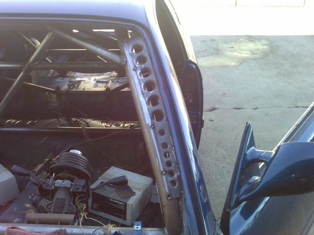

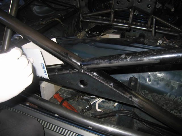

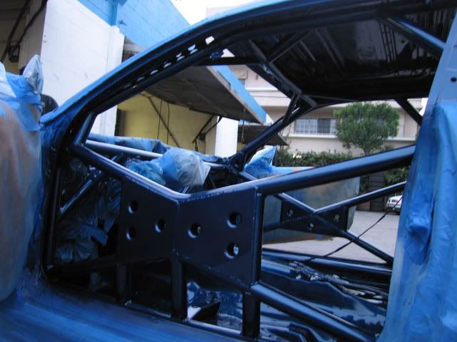

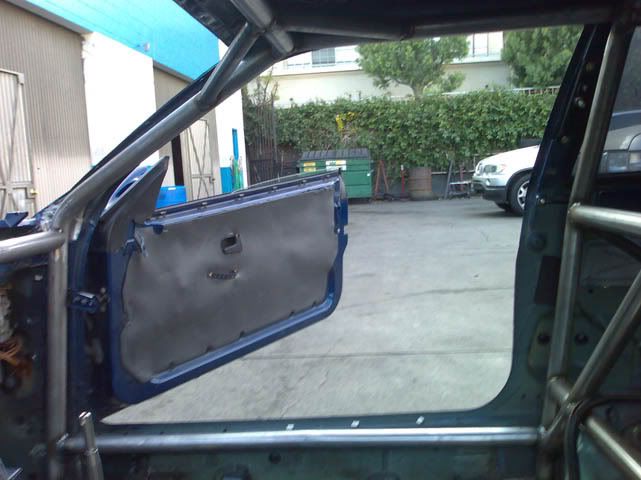

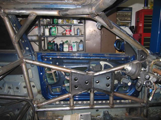

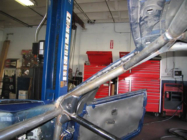

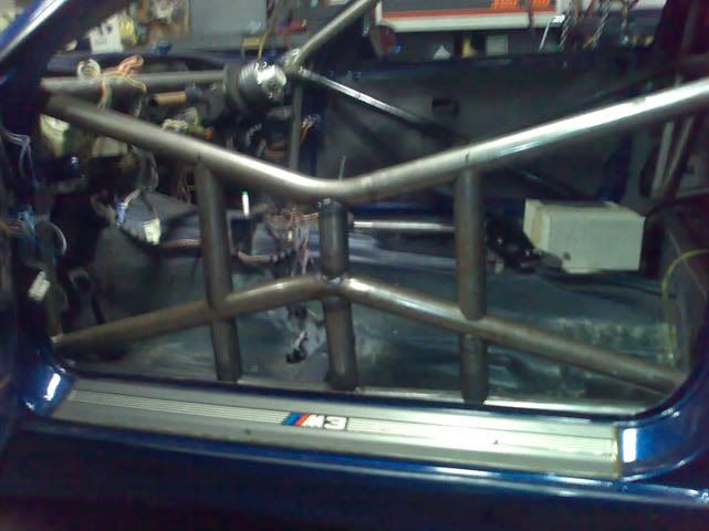

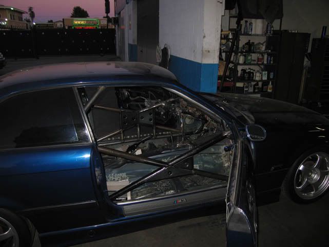

    Now me and Pedro both looked at ALOT of door bar designs and we came up with this hybrid design..........I think it's pretty good.......I know I feel safe!
    Then after some "arts and crafts" with some cardboard templates.....started going nuts with the new Dimple die's we bought! Started adding some dimpled gussets......

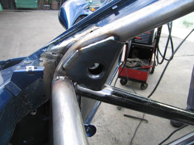

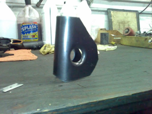

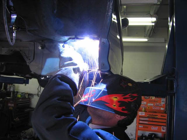

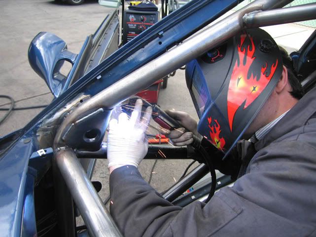

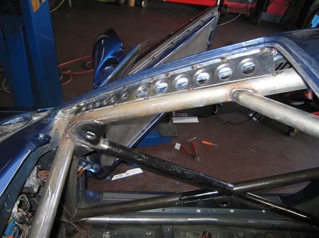

    Here is one of the A-pillar to door X gussets
    me welding it in...
    A-Pillar gussets tacked in...
    here you can see the X to A pilar gussets
    B-Pillar Gussets

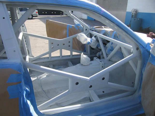

    more gussets.....
    Then started working on the passenger X gussets..... here you can see some of the cardboard we used to make the templates...

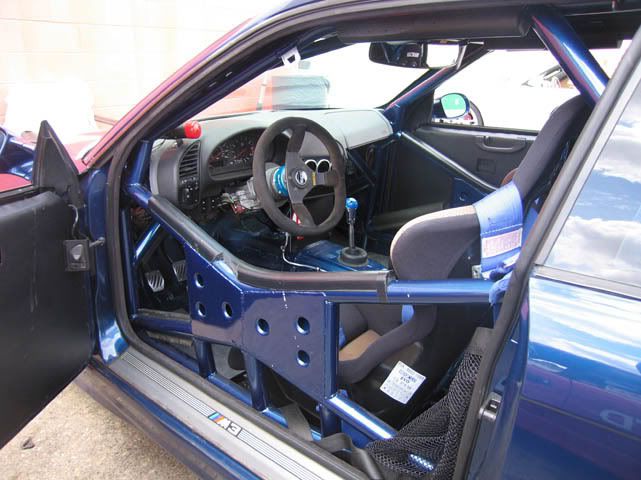

    also we did the driver side gussets on the door bars.....here is the finished driver side door....actually later we added mroe taco style gussets on the X bars where they meet the B-pillar tubes
    here you can also see the B-pilar to roof bar tube gusset.
    now.......I really wanted to extend the cage to the front shock towers at this point but I didn't feel like extending the project another month or so and really just wanted to drive the car already!!
    So maybe at a later date I'll extend the cage to the engine bay for now I just added some footwell protection tubes......

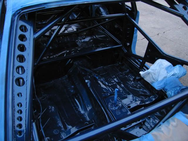

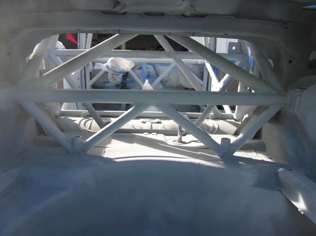

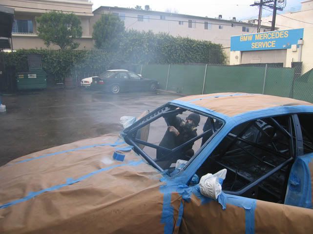

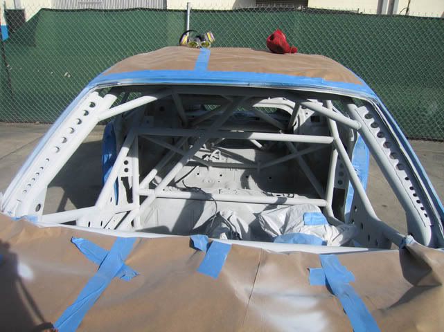

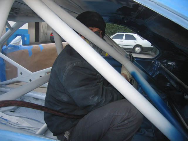

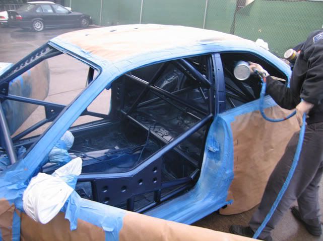

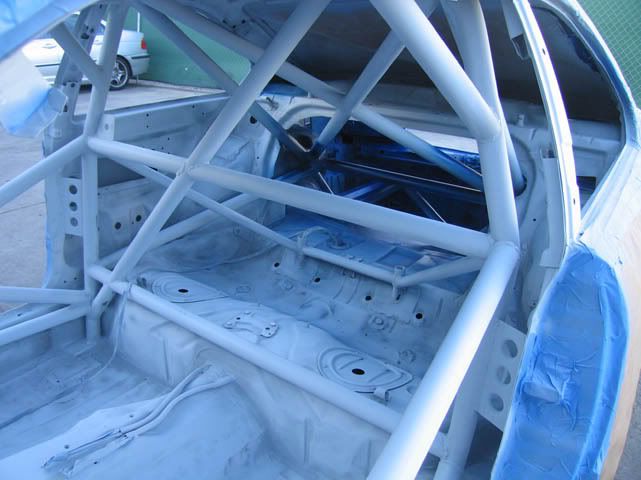

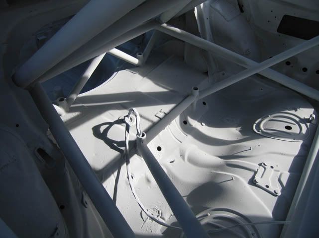

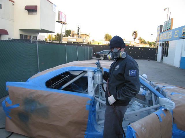

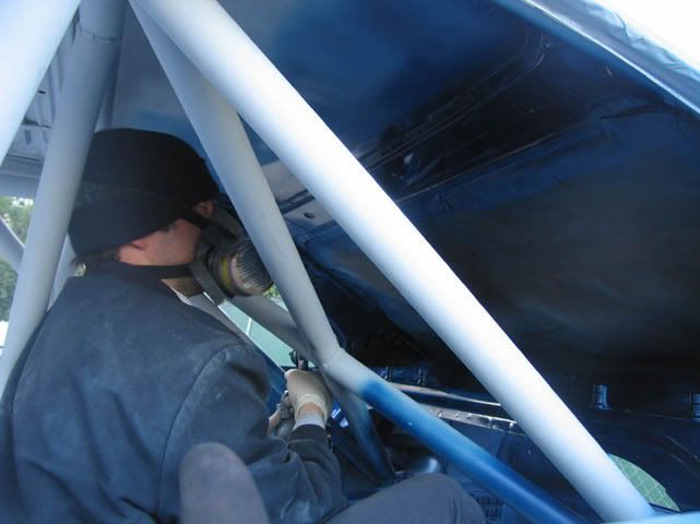

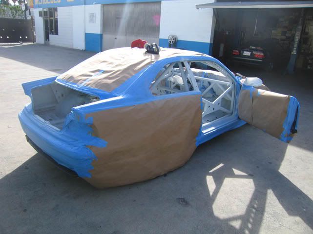

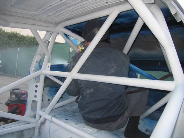

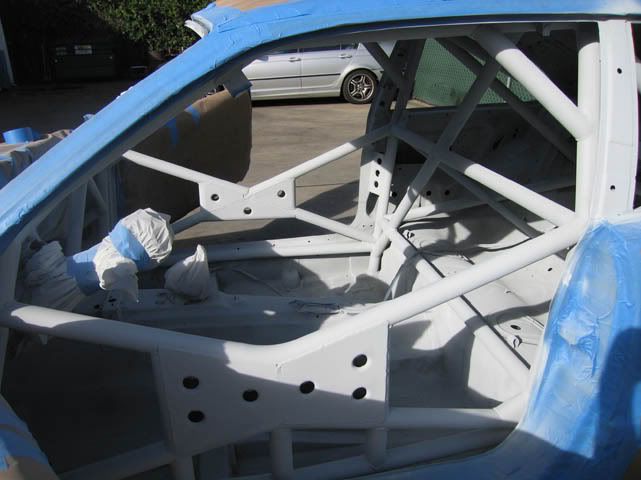

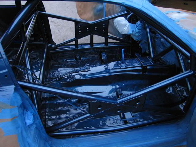

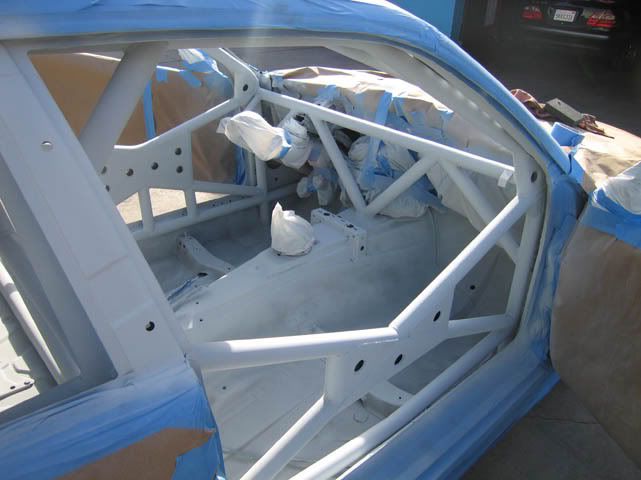

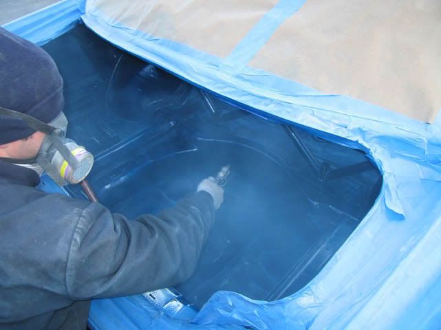

    Prime time.......

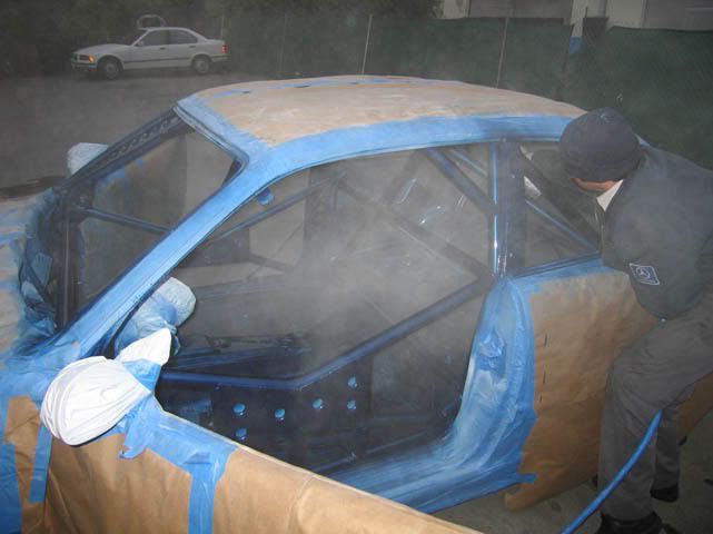

    **Looking back.....I wish I would of just brushed on some POR-15.....would of been easier and more durable. If you about to paint your cage look into it! **

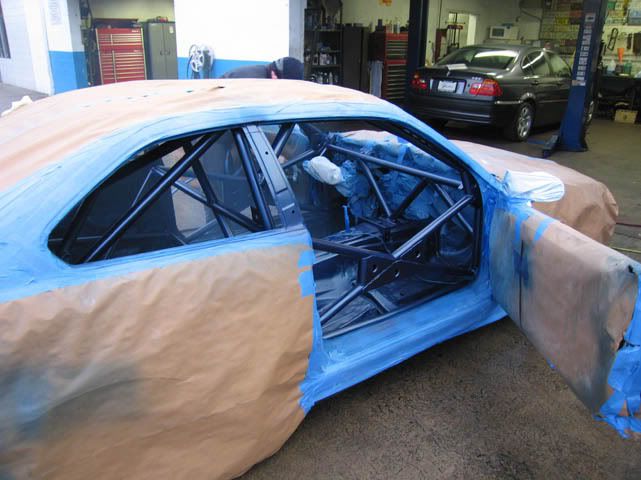

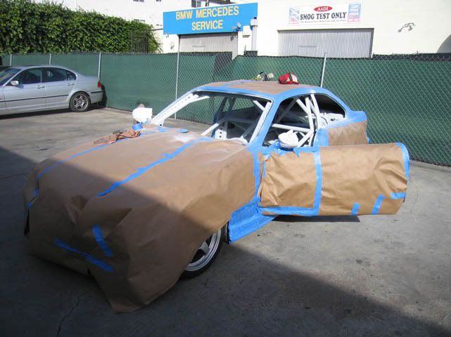

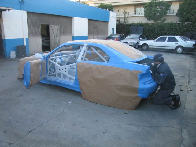

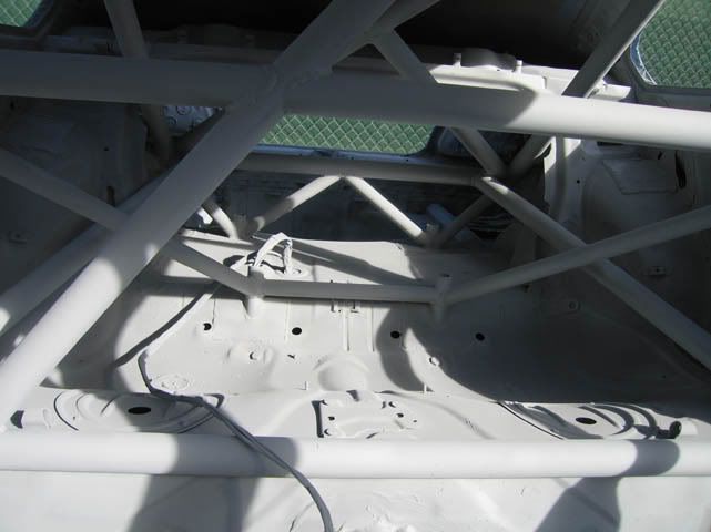

    So we bought some supplies masked the car as much as we could and started by spraying on some primer....
    There me lost in the spray...

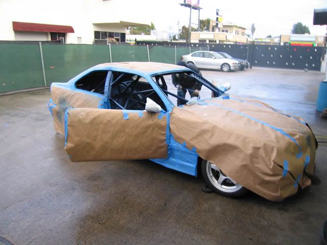

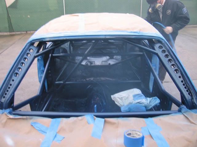

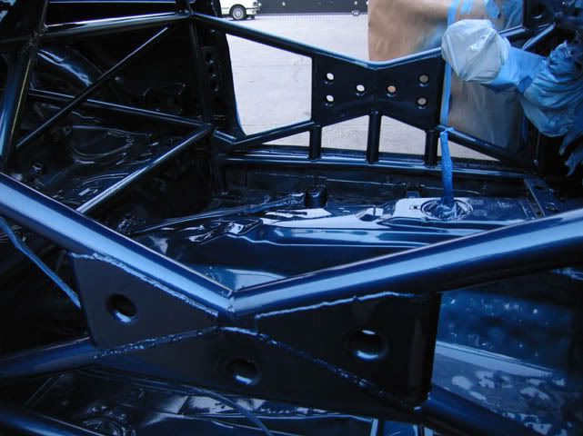

    base color....AVUS BLUE.........
    Avus Blue I love you......
    well why not color match with the exterior?
    Here we go! 1st coat....
    the spray mist was nutz.....

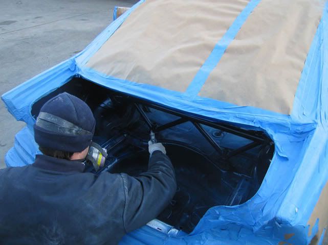

    OH YEAH PAINTING A ROLL CAGE SUCKS!!!!!! ARGH!!!!
    Why? look at this picture....
    In this end tough, it's a sweet victory.....and you get to wear a sweet mask...
    2nd coat....

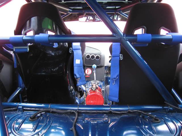

    beautiful......clear coat time.....
    TIme for the clear coat!
    Definately the best stage of painting, since the avus blue just comes alive!
    Clear coat MIST.....
    SEXY.......at least I think!

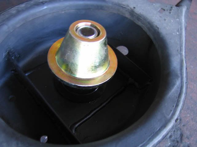

    Now that the car is going back together I installed some VAC solid alum. subframe mounts.....

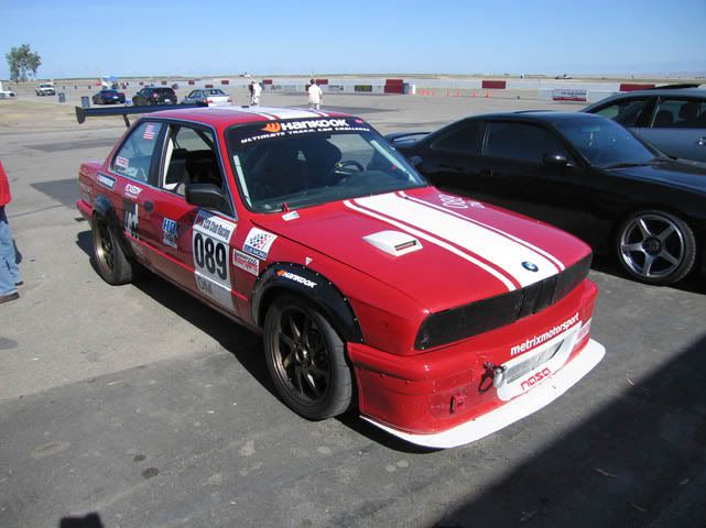

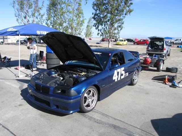

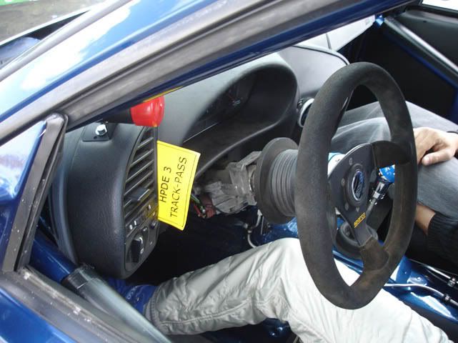

    My first Event !!!!!!

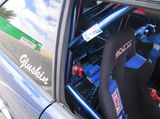

    After reinstalling my dash, seats, gauges, belts, fire system, battery cut off, window net, cage pads, battery etc....
    It was off to my first event! A NASA weekend I entered in my usual spot in HPDE 3 group.
    Today I just wanted to shake my cobwebbs of my brain and shake the car down.....

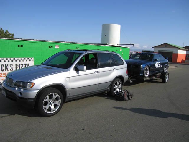

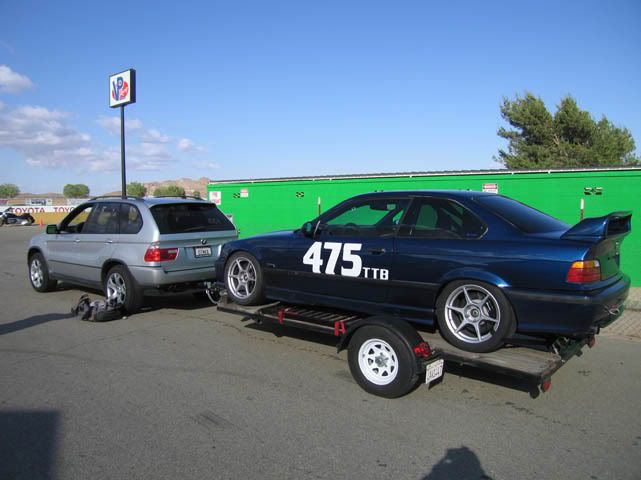

    We used Pedro's single axel trailer that he uses for his 2000lbs 2002. I was a bit worried but it towed just fine..... altough we were pushing the weight limits on the trailer tires. SO we kept it at 55 mph at all times(on cruise control). The X5 passed with flying colors and is truely (for me) the ultimate towing machine! I think we got 15mpg that weekend. The brakes were fine and the engine was more than powerfull.....
    view out the sunroof en route to Willow springs......

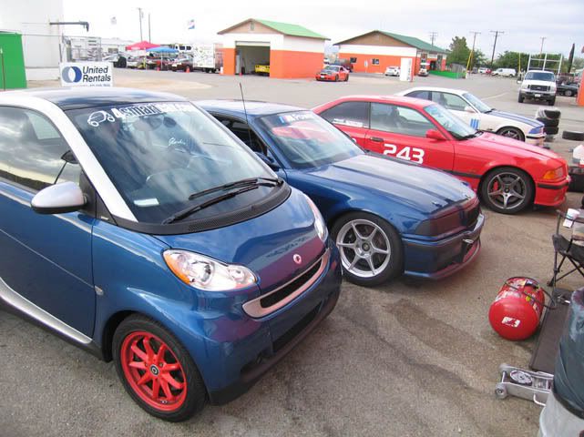

    Set up next to my friend John (also head instructor with NASA) and his red M3.....
    My friend also came in his SMART car........nice bunch we make huh?

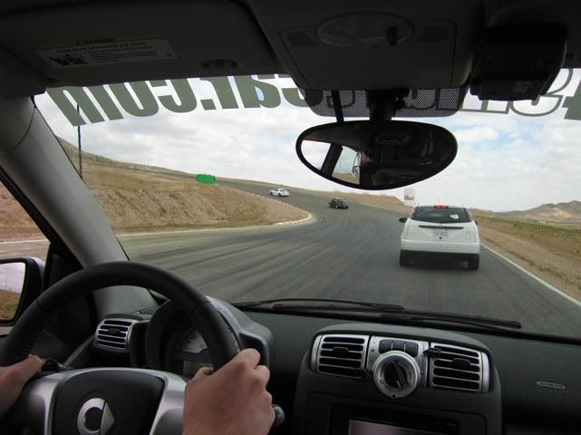

    Pedro actually went out with my friend in the smart car.....I think he we were the first to track a smart car in the US......

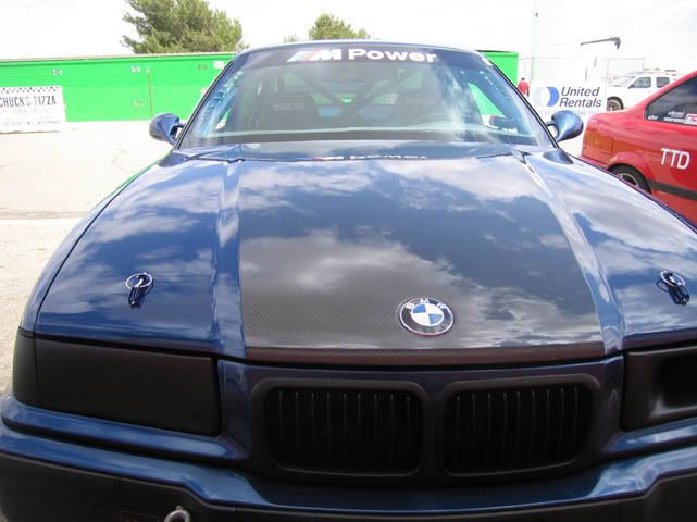

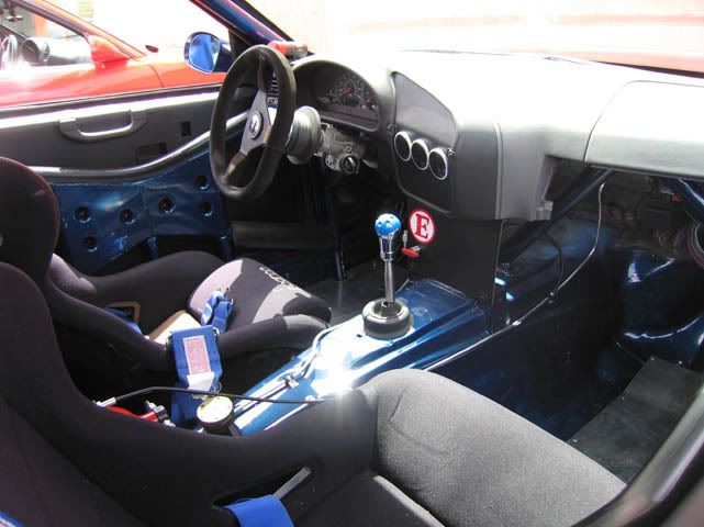

    Here are the completed pics...
    Here are the complete glamour shots from that day....
    Finished interiror
    battery disconnect,

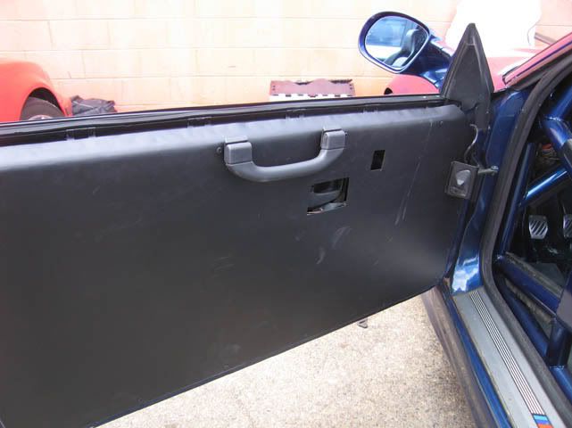

    Our fabricated alum. door panels (spray painted flat black)

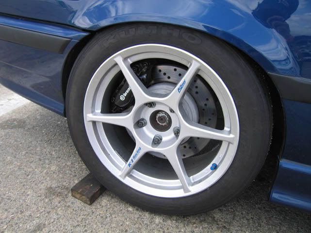

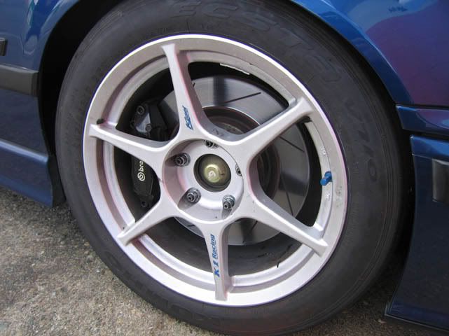

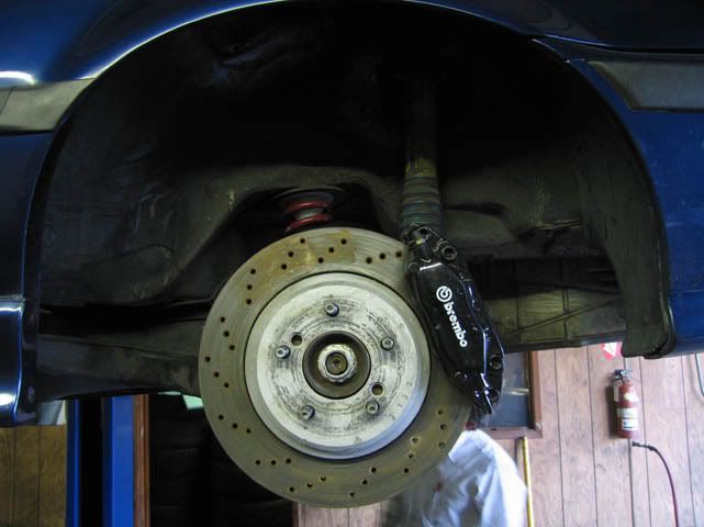

    Front and now (new) rear brembos

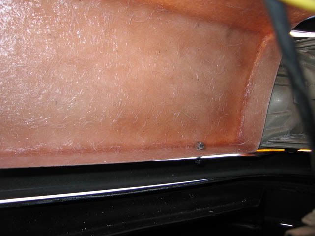

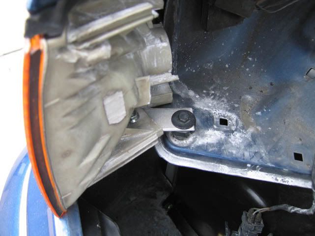

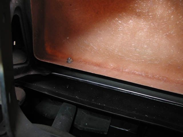

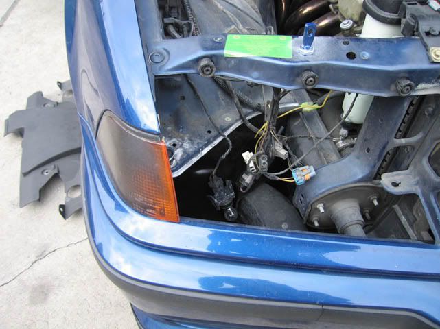

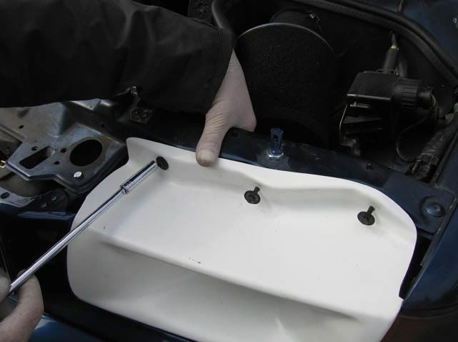

    Opps.......here are the pictures from installing the fiberglass Turner motorsports air ducts...
    First we started by making a small alum. brackets to hole the corner lamps in place....
    mark and drill the holes on the top part
    then we drilled the sheet metal along the bottom lip and but small nut and bolts to hold the bottom in place.
    done... then I sprayed everything flat black

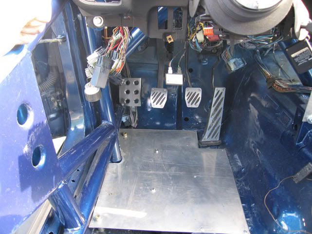

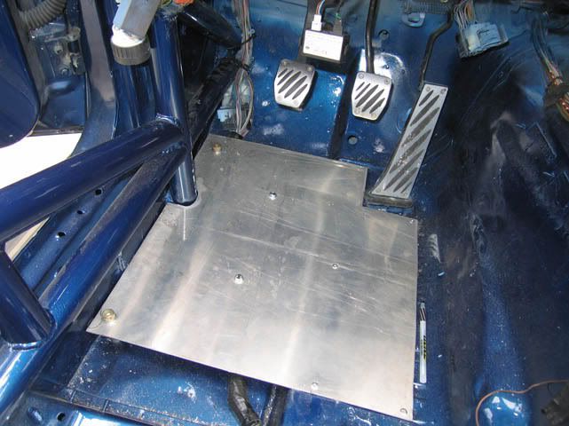

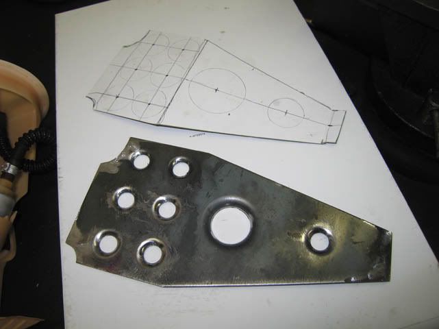

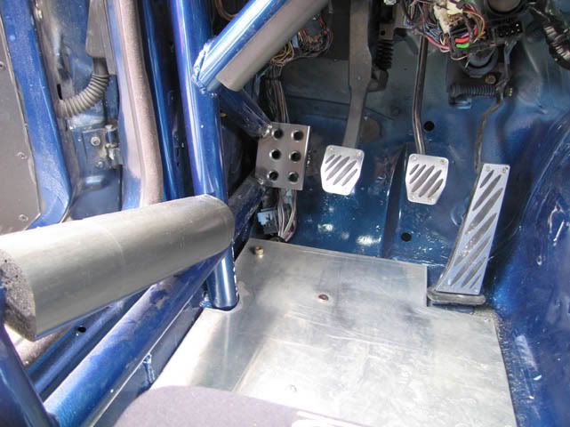

    Also........made an alum. floor board. ( here you can see my foot protection tubes I talked about earlier)
    Sep 2006
    LA, CA
    377
    95 M3

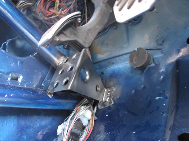

    Dead Pedal
    I decided to make myself a nice dead pedal....started by making a cardboard template....then replicating it in sheet metal, then a making the dimples and bending it and finally spraying it grey.
    welded in place......

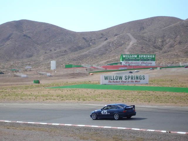

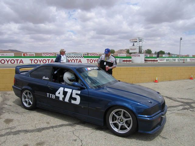

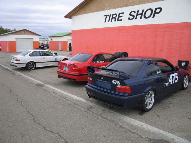

    2nd event at button willow.

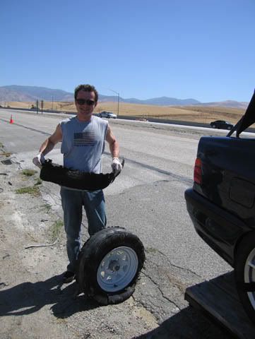

    Next up was A NASA event at buttonwillow, same weeked of the 6-hour enduro and the Ultimate track car challenge so there was a ton of fast cars to watch and compare my times with!

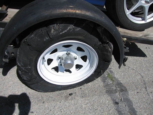

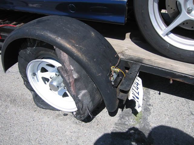

    We were always worried about pushing my old trailer tires. Naturally on the way there while at 55 mph.....BOOM....blowout! Scared the crap out of me and Pedro but maintained control the whole time and slowed down and pulled over.... whew!!!
    Me holding my trophy!
    Check your tires folks!!! the thread was good but they were 2 years old. They reccomend change your tires every 2 years.....We will replace with better ones.....
    Car ran great once again......I managed a 2:08.....John drove my car and squeaked out a 2:03!! ....and he was complaining about a understeer....
    John took my girlfriend for a ride in the blue monster....
    Next up he took her for a few fast laps in the M42 Turbo powered E30......
    She had lots of fun and I think john only managed a 2:04 in that session in the e30 (later I think they got the car to run a 2.00 flat or somethign like that)

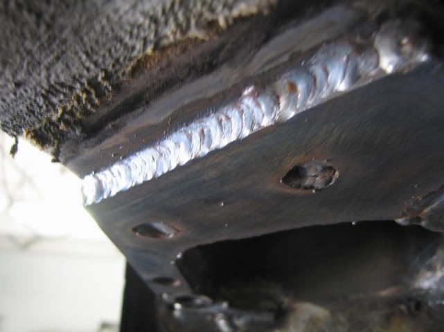

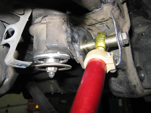

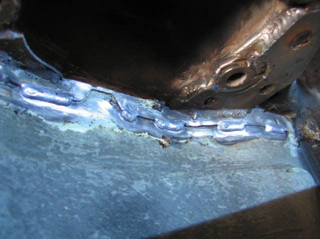

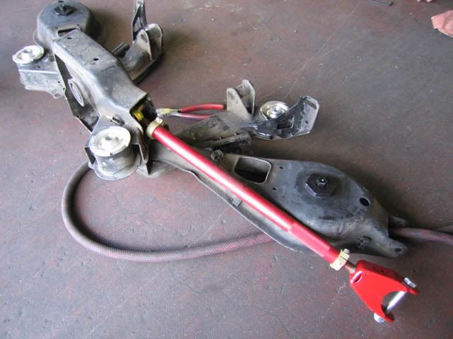

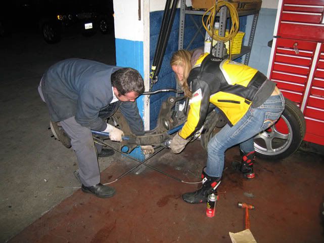

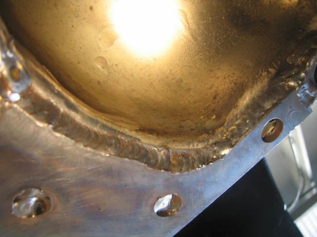

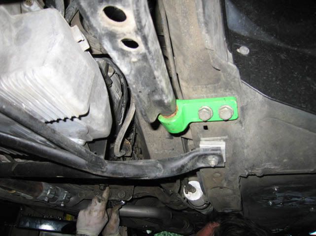

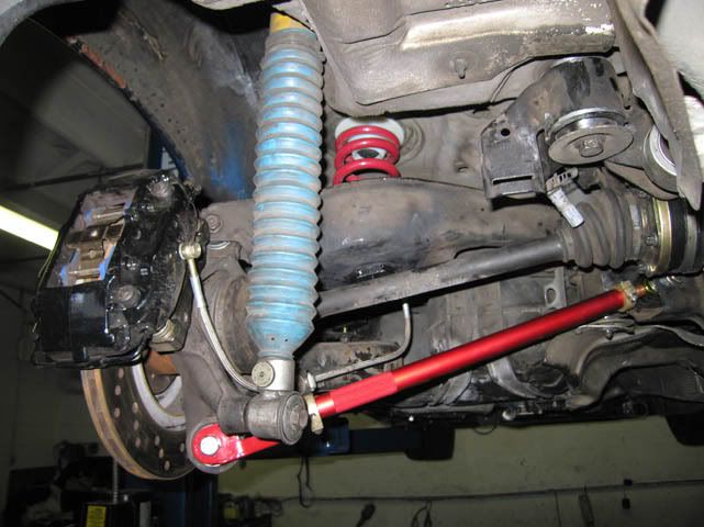

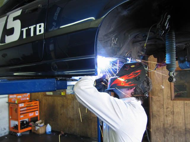

    rear suspension overhaul.....

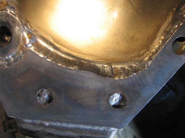

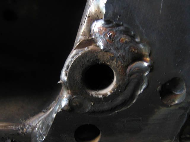

    Well........I just couldn't stop myself....even tough John proved the car had plenty of speed already.....
    I decided to increase my spring rate, add GC camber arms, monoball bushings etc....

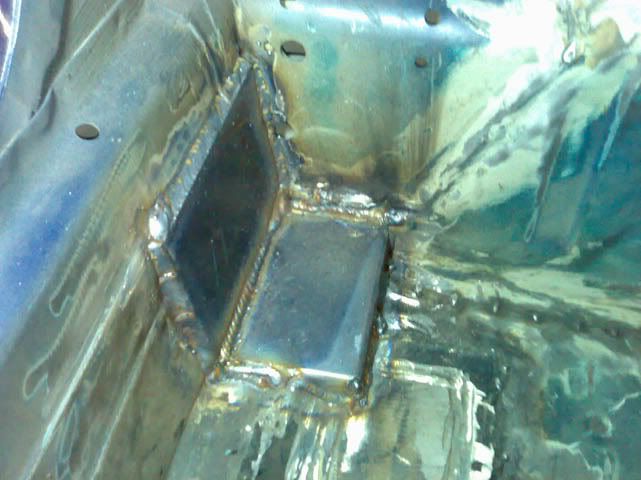

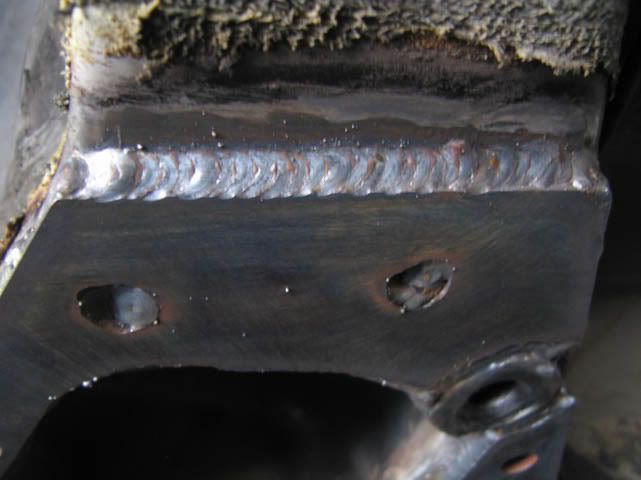

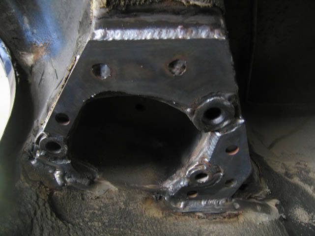

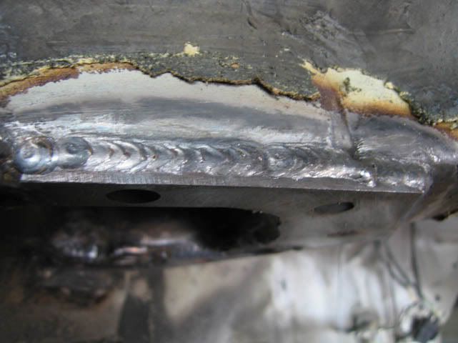

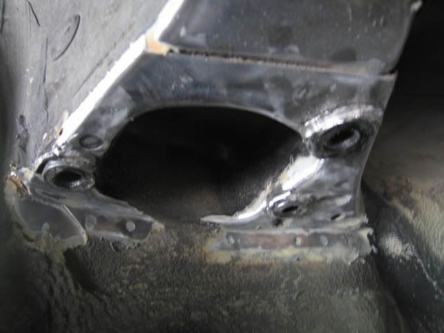

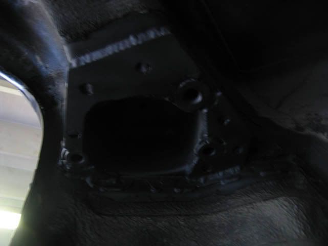

    more importantly also reinforced my chassis.....as you can see it was already cracking !!!!!!!!! ( I had already reinforced the rear sway bar, front subrame etc...)
    a bit of seam welding....
    painted
    Sep 2006
    LA, CA
    377
    95 M3

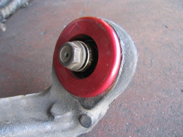

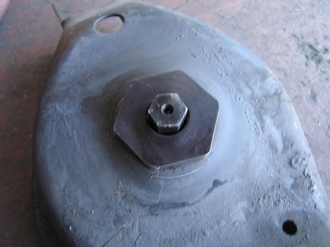

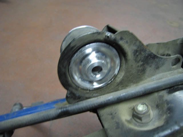

    GC goodies.......
    GC goodies......
    adjuster.....sweet design.
    complete subframe assembly with new arms etc...
    Nice factory tool for installing the half shafts.....makes it easy.......easy...
    front control arm bushing

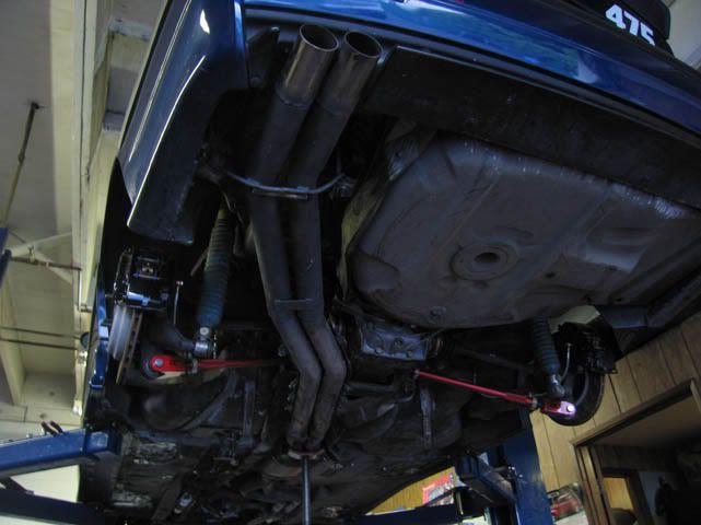

    New......exhaust....yeah no muffler, I like my race cars loud and fast. Much lighter this way too.....

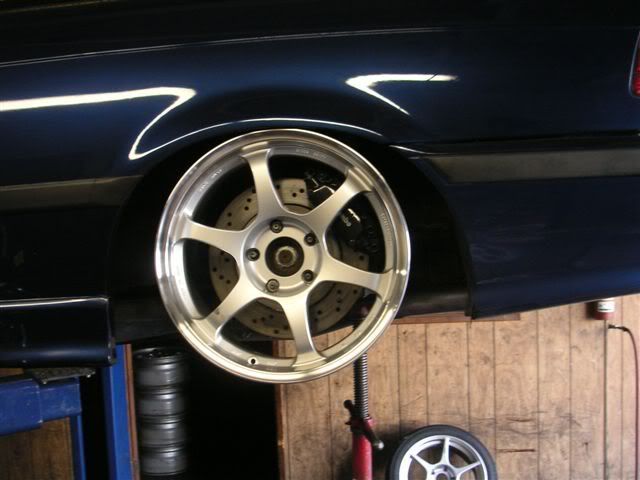

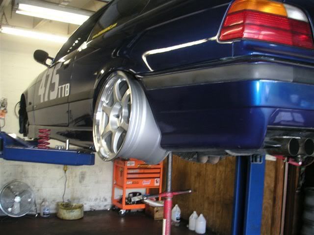

    where's the beef?

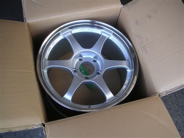

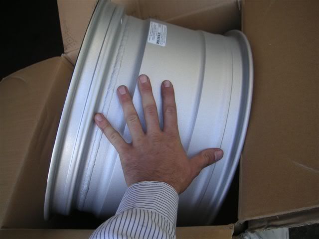

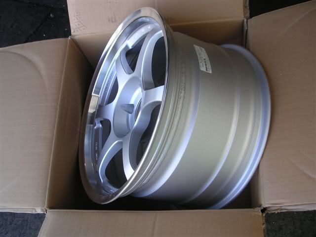

    Well.....once again just couldn't help myself!
    Tirerack had a good deal on them what can I say....

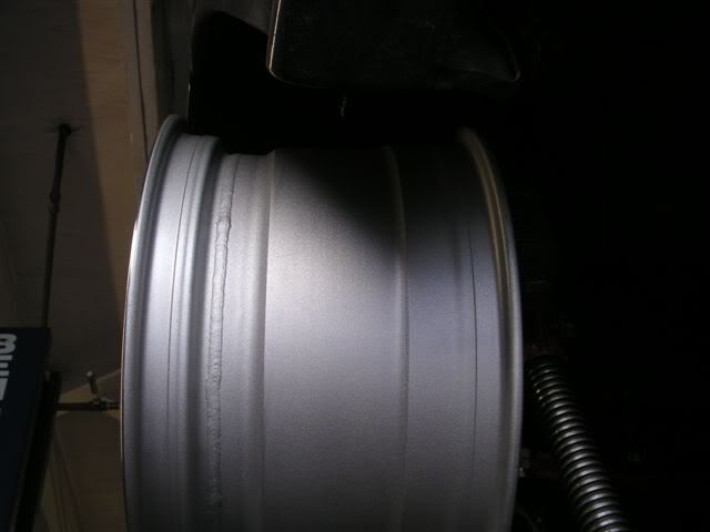

    SSR type CH - 17x10's - +35 offset around 17lbs.
    Plan on using grand-am take offs with these rims..... okay, okay so it will take some "massaging" of the fenders to make these work but it is doable.....I think....... we'll find out !!
    Here some teaser pics.....
    full compression.....

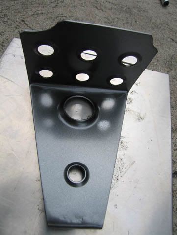

    are the SSRs 17x10 or 18x10? I don't think any of the take offs you're looking for are in 17" diameter. also, what spacers are you using? are you getting tire rub with the 10" wheels on the fenders? I had to add flares to prevent rubbing on my rear quarters at full compression

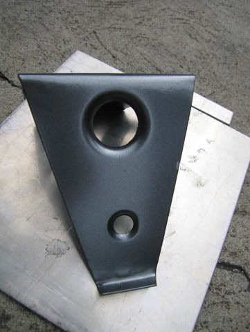

    one more question.....the RTAB supports you welded in....are those custom or did you buy those somewhere?

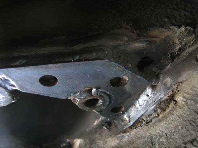

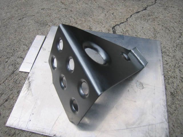

    It's 17x10, waiting for 245/40/17 Grand Am Hoosiers scrubs and they run really wide, but if they wont fit i'll try NT-01 275/40/17. They are on the tall side, will see how it fits...
    I ordered RTAB pocket reinforcement kit from BW, and it's pretty straight forward job, make sure you clean everything reall good before welding, and cleaning there is a pain!
