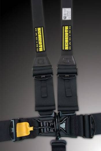

Have you considered the SafeQuip Latch and Link Harnesses? They aren't as pretty as the camlocks but have some benefits (cost, ease of adjustment).
The thing I like about them most is that the lap belt adjustment happens at the center buckle. For me (165#) the lap belt buckles for the camlocks are always in an akward location.
I had mine built to accept the HANS. They narrow the shoulder belts.
They have both 5 and 6 point lower belts.
I think you could get them for about $100 a side.
